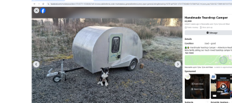

Not even the tiniest patch on your masterpiece Mike but I found the mudguard design on this teardrop interesting. It occurred to me that a bit of modification could incorporate a step or even storage for wheel wedges, jack etc.
